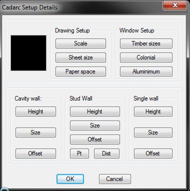

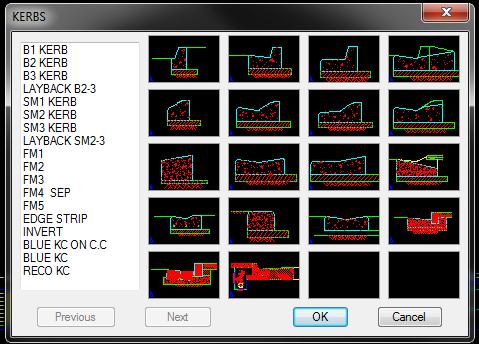

Like above tool palletes took over from older slide methods but I still use them you can also do custom lisp & dcl image arrays. If you use DCL you can have sub sub to choose from similar to Tool Palletes.

Using dcl I have a series of generic pick screens 2x2 3x3 4x3 etc and these populate using images its fairly easy to make the images but you do end up with a lot some where. The lisp just uses a list for images and command processing. Like you say Blackbox it comes down to how customised you really want it.
