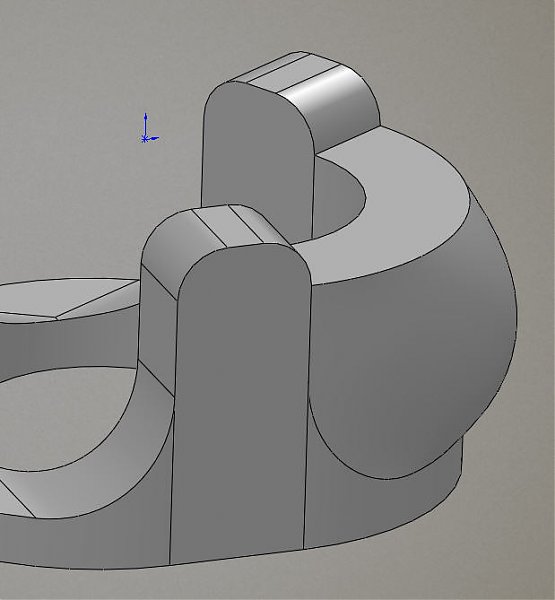

Please see the attached photo. I am trying to make a 'bulge' that is in the C shape of the orange sketch that follows the half-circle (grey sketch), and that ends on the gray surface. I have tried sweep and loft, but my main problem is ending on the 3-d (non planar) surface. Is there a way to extrude only to that surface by following the grey curve? Please help me out if you can.

You can Sweep your top sketch using the other arc as a path. this wont "meet" the curve on the bottom but will give you most of what you are looking for. You can also add guide curves to the sweep but i havent played with this feature in an instance like your part.
Another thing you can do is convert the edges of the grey part using convert entities and use them as your second sketch(3d sketch) for a loft. I added red lines to your picture to show you which lines to use. since the other lines appear vertical this may work out just fine, then use your vertical arc as a guide.
