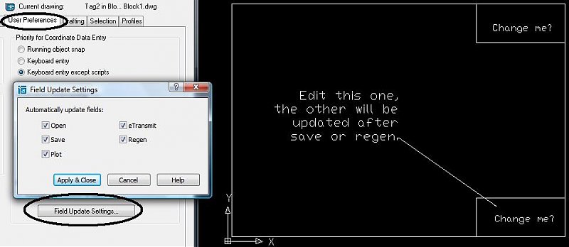

olliebr Posted December 11, 2008 Posted December 11, 2008 Afternoon, *NEW MEMBER ALERT* im attempting to knock up some frames for A1 drawings using attributes for revisions, titles, drawing numbers, etc. the drawing number/revision will be displayed at the bottom right and top left of the drawing (top left will be vertical). I was wondering if its possible to create one attribute which updates both references, this will avoid problems in the past where the bottom one gets updated and the other is left in its old revision, just another way of minimising human error, (not that any of us are human enough for that sort of thing) Regards, Quote
Raggi_Thor Posted December 11, 2008 Posted December 11, 2008 You can use FIELDS in attributes or as mtext in the title block. Maybe this will work for you? Then you can use the File/Properties to change the fields. Quote

Raggi_Thor Posted December 12, 2008 Posted December 12, 2008 I havent tried this, but you could probably set one of the attributes to Preset or Constant and use a Field pointing to the other one? Quote

Raggi_Thor Posted December 12, 2008 Posted December 12, 2008 Not so elegant, because I hade to insert Block1 before I could link Tag2 in Block2 to Tag1 in Block1. After a Regen Tag2 is now the same as Tag1. Tag2 in Block2 is linked to Tag1 in Block1.dwg Quote

Raggi_Thor Posted December 12, 2008 Posted December 12, 2008 It work for me. I don't edit the upper one, only the lower, block1. After I edit Tag1 in Block1 I have to do a REgen or a Save. Quote
dbroada Posted December 12, 2008 Posted December 12, 2008 I can get it to work using BEDIT. Is that how you intend for it to work? another EDIT if you then add other attributes, as you will have in a border, it requires 2 steps to work fully. Quote
Raggi_Thor Posted December 12, 2008 Posted December 12, 2008 No, strange, in my AutoCAD 2005 I only change the lower right attribute, with double click (EATTEDIT) or (the better) DDATTE. Then the other one follows automatically (after a save or regen). Quote
