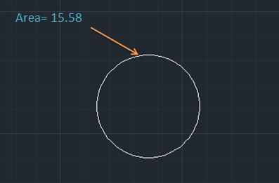

hamidciv Posted September 27, 2014 Author Posted September 27, 2014 dear mostafa, my mean is for example putting area or perimeter on the object which is shown beloow.(i want know which command do this in autolisp???) thanks Quote

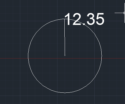

hamidciv Posted September 27, 2014 Author Posted September 27, 2014 dear asos for example written code for drawing circle that radius with leader dispalyed that shown follow, now i want text "area" put previous of radous in my circle on screen. i want exactly text "area" putted previous 12.35 in figure attached, with command do this in autolisp? Quote
mostafa badran Posted September 27, 2014 Posted September 27, 2014 (edited) try with this. (defun c:test (/ AREA AREAST ARST NP1 NP2 P1 ) ;mostafa badran (vl-load-com) (setq p1 (getpoint "\n Specify first leader point,")) (setq np1 (getpoint p1 "\n Specify next point:")) (setq np2 (getpoint np1 "\n Specify next point:")) (setq rad (vla-get-Radius (vlax-ename->vla-object (car (entsel))))) (setq radst (rtos rad)) (setq rast (strcat "Radius=" radst)) (command "qleader" p1 np1 np2 "" rast "") (princ) ) but you need to Identify size of text and size of arrows. HTH Edited September 27, 2014 by mostafa badran improve code Quote
hamidciv Posted September 27, 2014 Author Posted September 27, 2014 dear mostafa my mean this was exactly. thanks a lottttttttttttttttt for help me. regards Quote
