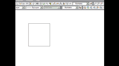

nestly Posted October 24, 2014 Posted October 24, 2014 I'm a little fuzzy on the attachment thing... but I don't think you can keep using the spline leader thing as a reason to stick with QLeaders. Quote

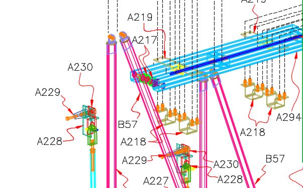

Dadgad Posted October 24, 2014 Posted October 24, 2014 (edited) I'm a little fuzzy on the attachment thing... but I don't think you can keep using the spline leader thing as a reason to stick with QLeaders. [ATTACH=CONFIG]51370[/ATTACH] nestly, thanks for the visual, but what I meant was that I do not want to have a predefined default landing and attachment point. I frequently do notes on very dense drawings, where I want to be free to use lots of different quasi-attachments positions, meaning some will be landed on the left, some on the right, some above and some below the Mtext. My Mtexts are free agents, often generated with one of Lee Mac's awesome lisps, which extracts the block name from an object and places the name (as Mtext) in paperspace. The screenshot may better explain what I mean. This is not a particularly dense example, still lots of daylight, sometimes very difficult to even find places to land the mtext without using a mask, which I try to avoid. Edited October 24, 2014 by Dadgad Quote

RobDraw Posted October 24, 2014 Posted October 24, 2014 Dadgad, I really like your leader style!!! It's very flexible for congested areas and easy to keep the text as close as possible. It's too bad that it would be extremely difficult to get over 40 users to adopt it and have it be at least be somewhat consistent from user to user. Quote
