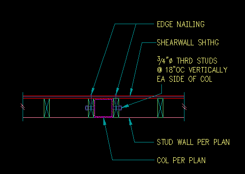

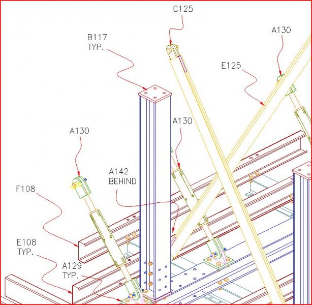

That one was not mine actually, but done by a guy whom I trained, I am mighty particular about the leaders.
I feel that they should be as elegant and well conceived as the engineering we do.
In my book neatness counts, anything less reflects poorly on the whole team.
A drawing well done engages the viewer.
A poorly or thoughlessly executed drawing alienates the viewer and casts aspersions on all that it encompasses.

Interesting... We've always rejected splined leaders, and I see better now why.
What I mean to say is, that your drawing is easy to read as a direct result of using splined leaders, only because your drawing is full of straight lines. To the contrary, as I work in Civil, most lines in our plans are derived from either contours, or some sort of curvature in the roadway, etc., so we strictly use non-splined leaders for readability.
