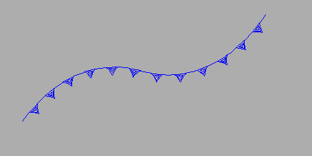

i was wondering if it is somehow possible to define a line style looking like the one in this screenshot? i searched around but wasn`t possible to find any solution to this problem. i am using acad 2014 and i would prefer to define the style by a color dependend plot style.

thanks for your answer, i just need it for my machine, cause i will be the one plotting all the plans for our project. i was especially looking for a way to produce linetypes like the one shown in the screenshot without having to put a lot of small triangles along the pline. if you have any idea how to define a line like this i will be very grateful for your input.

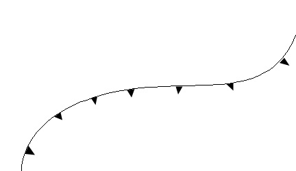

With a bit of time, I produced this. You can play around with the spacing to suit.
I called the linetype Front, because it reminds me of the meteorological Fronts
*Front,line with triangles --- ? --- ? --- ? --- ? --- ? ---
A,.5,-.27,["D",Symeteo,S=1,R=180,X=0.205,Y=0.43],-.18
