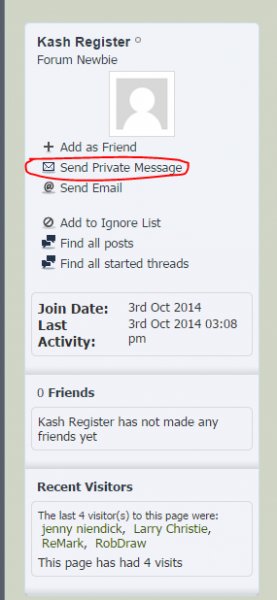

Psst.....
Forum Newbies
Like all busy forums, CADTutor attracts a lot of spammers and it is a constant battle to keep the forum clean. In order to improve our chances, we have put in place certain restrictions on the use of the forum by Forum Newbies. This is not intended to frustrate genuine new registered users and it's not because we don't trust you, it's simply the best way we know of stopping our forum being swamped by spam.
The following is a list of things that Forum Newbies cannot do:
Cannot use the personal messaging system.
Cannot post visitor messages to user profiles.
Cannot add a signature to your profile.
Cannot use custom avatars although you can choose one from our extensive library.
http://www.cadtutor.net/forum/showthread.php?56184-Information-for-new-members
Back to the OP
