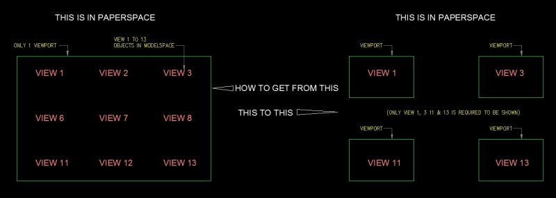

HELP: LISP to create multiple & resized viewport base on an existing viewport
One of my routine work is to highlight only part view of a drawing that has changes, to our consultants.
This involves creating individual viewports, of a specific view, out of that drawing (which could have 1 or more viewports).
I normally copy the existing viewport (no. of times will depend on the no. of views i need). Then i would pick 1corner of 1 of the copied vport & stretch it to the area concern, then stretch the other thereby resizing that copied vport to show a certain view of the drawing only.
I then repeat this process depending on the no. of changes.
If it would be possible, can someone advise on a lisp that can create the same viewport (using it as a base) (following the same UCS/layers that are on/off/frozen/thaw/lock/unlock) & with 3 clicks ( 1 click to select existing viewport, 2nd & 3rd click to create the 2 window corners for the new view port.
That would shorten my work time considerably.
Thanks

Attached is a picture explaining what i mean. Hope that would be clearer.
Please also note the following:-
- the viewport's view UCS is at an angle (meaning rotated) , as the drawing in modelspace is at an angle
- all are existing drawings (created 2 years ago)

While you cannot use ( entmake ) or ( entmod ) on a viewport entity, you can access the data and xdata via ( entget ).
This is a STARTING POINT ONLY !

Figuring out the view info and ucs would take some trail and error
Can you post flow chart of all of the command sequences that you currently use ?

Now that I see you sample, I doubt that it is possible to automate that process. -David

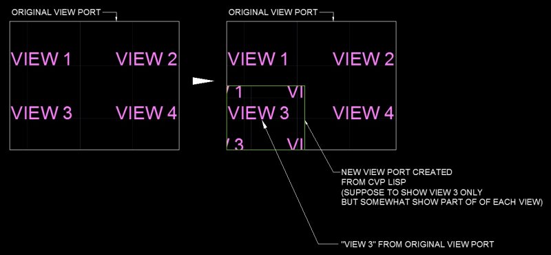

Tried out the lisp.
The steps & intention seems to be what i wanted (within 3 clicks) but the result of the newly created viewport is not the same view as the original viewport. Also, the view is showing the "Z" view. So i am seeing only 1 straight line
This is the steps of how i normally do.

Basically each view i will need to create 3 viewports.
1 for the drawing itself.
1 for the X axis grid line
1 for the Y axis grid line
Hope to find a possible solution. :sweat:
Just to clarify, i do not mean 3 clicks to get 4 viewports out of that 1 existing viewport.
More like 3 clicks to get 1 viewport would be out of this world for me. :P
Alternatively, is there a way to match new viewports (excatly the same) to the original viewport?
I tried that but the inside view is not in the same location & the drawing view was tilted :(

Hi David.
This is the results:-
- Scale & UCS orientation is same.
- Just that the location of the view is not. As show in the photo below
