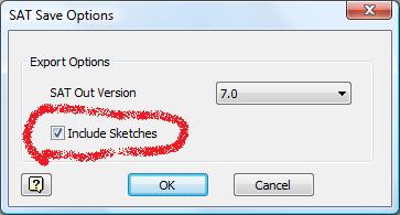

JD Mather Posted December 21, 2008 Posted December 21, 2008 If anyone does find out how you can export 3D sketches (no solids) out of Inventor, I'm still very curious... File Save Copy As ACIS (*.sat) type with include sketches Option. Then use acisin command in AutoCAD Quote
pvd Posted December 22, 2008 Author Posted December 22, 2008 Is this Inventor 2009? I'm using 2008 and I don't have the option to include my sketches. Anyway, at least I know now the possibility exists... Quote
