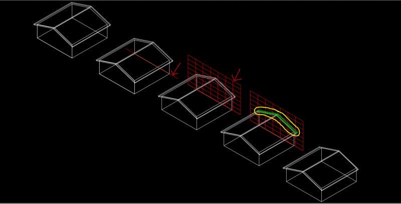

ReMark Posted October 23, 2014 Posted October 23, 2014 Nothing in the Help file? The option you refer to is a native AutoCAD command called SLICE. One of its options is the ability to slice with a surface. Quote
ReMark Posted October 23, 2014 Posted October 23, 2014 SLICE using the SURFACE option. This is for demonstration purposes only. I am not an architect. The red line at the rear of the second structure shown above is extruded to create a surface which is shown passing through the roof of the third structure. This surface is used to slice the roof and both sides are retained. The portion of the roof colored green on the fourth structure is then deleted leaving you with the fifth structure shown. Visual style: 2dwireframe. The structure is a 3Dsolid. Quote

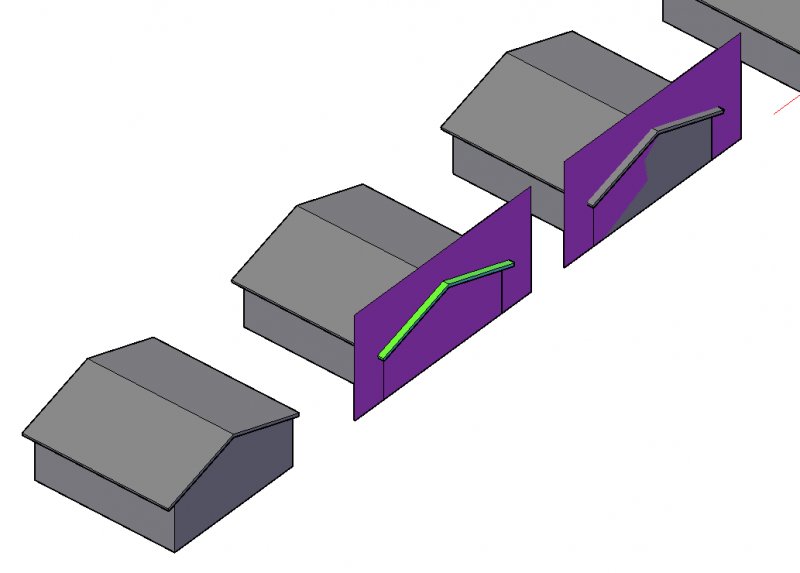

ReMark Posted October 23, 2014 Posted October 23, 2014 Partial view of the rear showing the slicing plane (surface) the portion of the roof (green) to be erased after the slice has been completed and the result. Visual style: Conceptual. Quote
tzframpton Posted October 23, 2014 Posted October 23, 2014 ReMark, the problem is that a Roof AEC Object cannot use traditional AutoCAD commands. You would have to explode the object, which "dumb's" it down to mere solid geometry. Here is a good place to start in the Help file regarding the AEC Roof Editing tools: http://exchange.autodesk.com/autocadarchitecture/enu/online-help/search#WScedd0d2069f88934137c60dfa2566c4c1-7ff8.htm Maybe the answer can be found here. HTH Quote

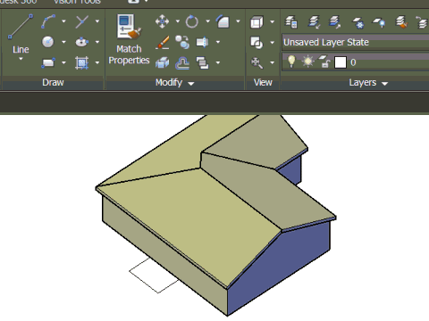

nestly Posted October 23, 2014 Posted October 23, 2014 As I stated previously, I'm not an ACA user, (this is my first "roof" ever) but as soon as I selected a "Roof Slab" the ribbon gave many options to modify the roof slab. In the animation below, I chose "Hole" and used a closed polyline to simulate a chimney extending up the wall and through the roof. I have no idea if that's a proper technique. Pressing "F1" while hovering a tool should bring up context sensitive Help about the tool. Quote
tzframpton Posted October 23, 2014 Posted October 23, 2014 (edited) That's because you used a Roof Slab, which is different than a Roof in ACA. Maybe that's the ticket? Good screencast nestly, as always. *EDIT* Now that my memory has jogged a bit, I do remember you have to covert to a Roof Slab before any advanced Roof editing can be done. This has got to be the missing step. Just don't use ACA anymore... Thank goodness. Edited October 23, 2014 by tzframpton Quote
