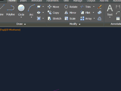

However AutoCAD also comes with multiple BREAK tools accessible via the Ribbon, toolbars, or the menus to automate the process of breaking at a single point.
BREAK command prompts to specify a [F]irst point then a 2nd point. As above, specify a distance of @0,0
[ATTACH=CONFIG]51383[/ATTACH]
On Mac... UI doesn't look like that for me.
