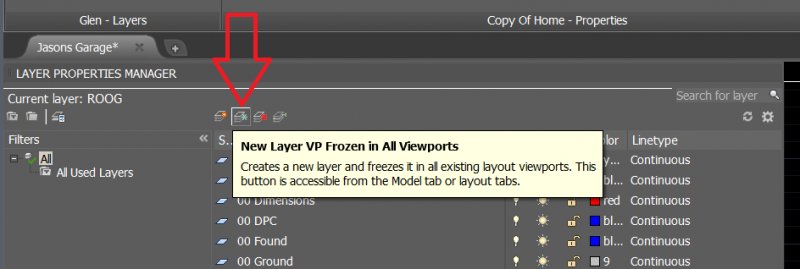

designerstuart Posted October 27, 2014 Posted October 27, 2014 hi all anyone know a magic way of adding a new layer without it showing up in all the paperspace viewports i have already created? sort of like the 'frozen in new layers' box, but for existing VPs. follow? thanks Quote
BlackBox Posted October 27, 2014 Posted October 27, 2014 AFAIK, you can either Freeze the layer using -LAYER Command, etc., or to use -VPLAYER Command (for each Viewport) to do same... Otherwise, custom code is needed. Cheers Quote
Glen1980 Posted October 27, 2014 Posted October 27, 2014 hi all anyone know a magic way of adding a new layer without it showing up in all the paperspace viewports i have already created? sort of like the 'frozen in new layers' box, but for existing VPs. follow? thanks I don't know if you have that button in 2009 but I think it's been there a while now. Quote

designerstuart Posted October 27, 2014 Author Posted October 27, 2014 dammit! thanks blackbox. just to clarify, i want to draw some new geometry in my model space. but this must not show up in any of the existing layouts, because they are perfect! i will then create a new layout with a viewport that does show the new geometry. for this reason i cannot just freeze the layer off completely. the only workarounds i can think of are: 1 draw the new geometry in paperspace - not very tidy! 2 do some sort of xref which you only load when you view that layout thing. terrible! Quote
designerstuart Posted October 27, 2014 Author Posted October 27, 2014 hah glenn just ssen your post after posting the above. thanks so much i will try......... Quote
designerstuart Posted October 27, 2014 Author Posted October 27, 2014 perfect, thanks all. glen: looks like i owe you a beer. shall i bring it round?! rob: what was the other thing? if you didn't know it, chances are i won't! Quote

BlackBox Posted October 27, 2014 Posted October 27, 2014 FWIW - Layer Manager silently invokes the appropriate LAYER and VPLAYER Command to do what you manually perform within the Palette's UI. This can be observed using MgdDbg Events; here's a quick video demonstration. Cheers Quote
