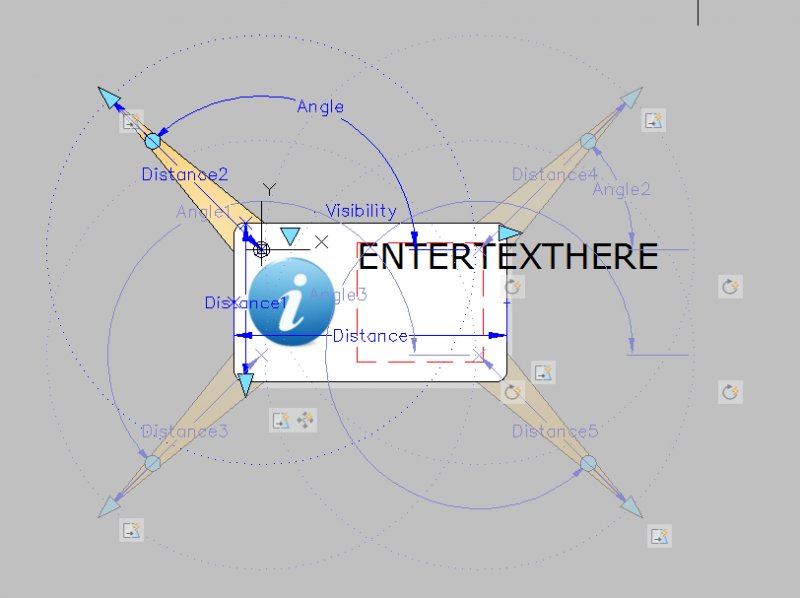

It's been a while since I was here. I am hoping someone can help. I have a dynamic block that we use to denote things on out non technical drawings. The blocks has pointers at all four corners on visibility states.
The block can be scaled along the horizontal and the vertical axis independently.
We also have text. I have in the past sat text on top of the block, but there are always issues in that it constantly needs to be brought to the front etc.. Now I am trying to include it within the block. The text has to remain editable. I have tried using an attribute, but I cannot scale the width of the attribute. Is there any way around this?

Thanks RobDraw. But that was not the question. I don't want to scale the text width, but the attribute width, meaning the amount of text that appears on each line of a multiline attribute.

Oh well, I tried given the wording of your post. You did say scale. Your talking about the width of the text box for multi-line text.
Yes, I did, scale the attribute.
You do not want to scale the attribute. You want to change the size of the box that contains the attribute. Which, in turn, will affect the number of lines of text, not the width of the individual characters. Which would affect the total length of the line of text. Correct?

That's it. That's what I mean.
