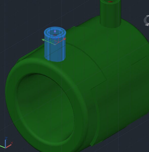

I am new to autocad 3d and I am having a problem fillet the edge were two solids meet. I want the fillet the edge of the highlighted blue part where it meets the green part. Please help

...fillet the edge where two solids meet.....
In AutoCAD, FILLET does not work between two different Solid objects... you'd have to UNION them so it's one object first.
Thanks nestly that worked. I am new to autocad and used to pro/e. That worked I really appreciate the help.
