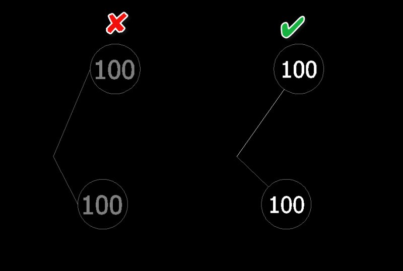

Many thanks again SLW210! That is yet another way I could satisfy the requirement, however I am still looking for the ability for the leader to always center on the circle as I think it just looks cleaner.
