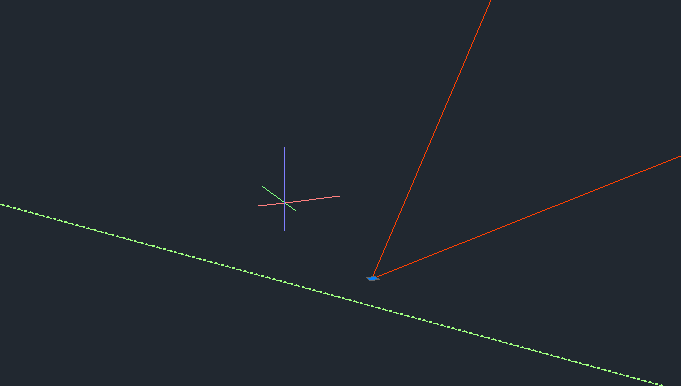

In fact, when selecting the spline and activating display fit points it shows the fit point on a cross section vertex -> see picture.
I don't think that is actual problem with loft because I had the same anomalia with previous loft and it worked fine.

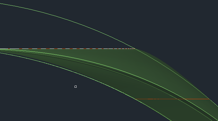

Now, selecting guidelines just makes loft disappear. Here are pics before and after selecting a guideline.
I don't know where I'm wrong...

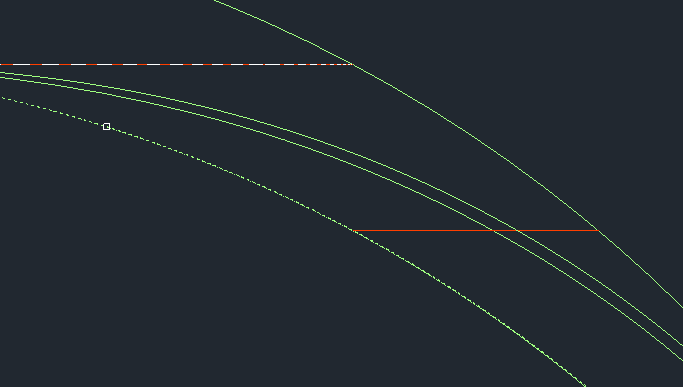

Interestigly, the problem wasn't in the cross section-guideline snap points but rather in the guideline spline shape at the top profile. See pic ->
Green guideline is the "ideal one" (Ideal - meaning it gives the perfect shape) on which the loft didn't work. This line ends as a tangent on the last fit point on spline (near cursor).
Golden guideline is the default spline without end tangent adjustment. This one lofts with no problem but gives awkward shape when completing model.
Red line is kind of a compromise between green and golden. It gives acceptable shape and works as a loft guideline. Cad acted pretty weird with this one, because I managed to loft it only after several tries. It seemed to me like guideline selecting sequence determines whether you can pull of the loft of not :D
Could it be a general "problem" with Cad that it won't loft alongside guideline that is tangent to profile/cross section?
