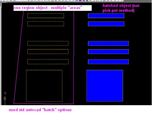

Hello All,
I need to hatch a region w/ multiple areas:
Tried modding the example code for :

invalid input here:
hatchObj.AppendOuterLoop outerLoop
obviously there is no "OuterLoop" but its really simple to hatch the object using the std autocad Hatch command and the options with it. Any ideas?

did you try
Dim outerLoop(0) As AcadEntity
instead of
Dim outerLoop() As AcadEntity
ReDim outerLoop(0)
sometimes vba mistake from variant to other types...
Do you have this problem with every region or only some of them?
For me this kind of approach: appending loop - evaluating, always worked with closed objects (and a region is closed)
