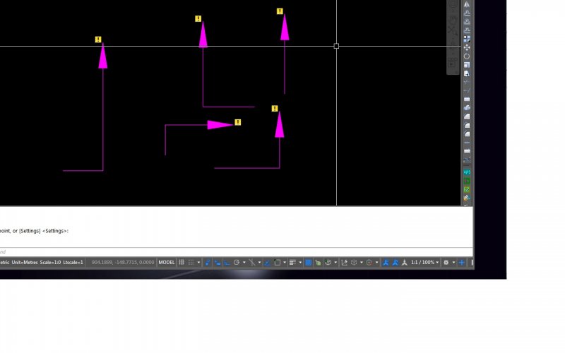

I suddenly change variable setting // help me plzz
and added "!" symbol to end of qleader , how can i fix it??:o
Try disabling the annotation monitor feature (in your Status Bar) and see if they disappear.
+1 ... it's the "Plus" symbol at the far right in your screenshot/status bar.
The icon means the dimension object is not associated with any geometry.
