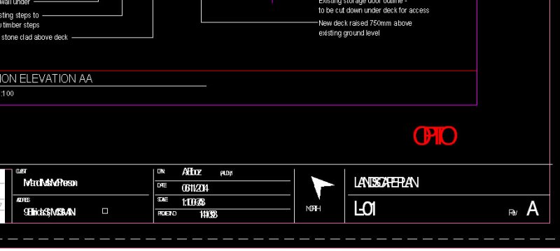

I am working with autocad 2008 and have an issue where the text in paperspace squashes (see attached image). The text in modelspace is fine (see image – the pink line is the viewport). There are four other people in the office working on the same version of autocad and they don’t have this problem.
I can temporarily fix the text by changing the elevation to 0.01, then it reads fine on my screen, but opens up squashed on everyone else’s computer

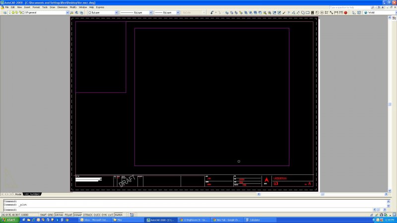

Please find attached dwg file. I have also attached a screen shot so you can see how it opens on my machine.
Thanks heaps for your help :)
for mez.dwg

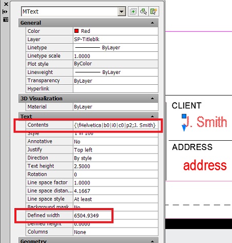

The text appears normal to me when opened with AutoCAD2011, but I did notice the text seems to have unnecessary format overrides, and the defined width is excessive.
I would try recreating the texts without the overrides and with a more appropriate width as see if that changes anything.
