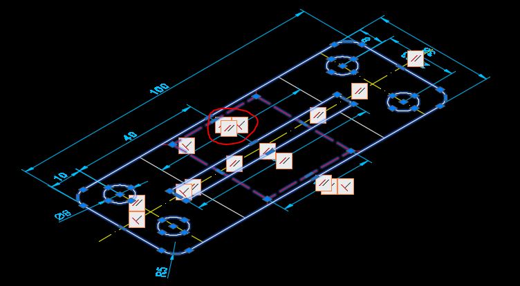

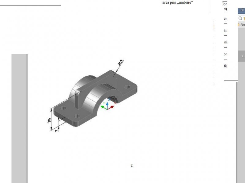

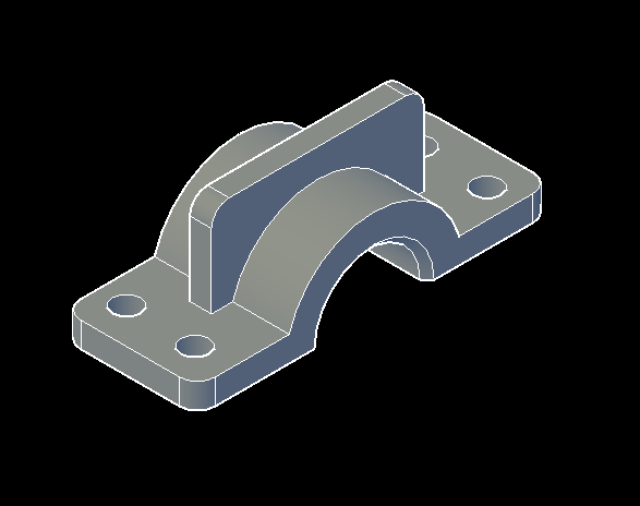

sandualex Posted November 17, 2014 Posted November 17, 2014 OK,so I know that you cannot trim an object in 3D,and I already tried SUBTRACT command,but with no use.I need to mention though that I'm no expert in 3D modelling,and I may have missed some things to be able to create the final object.I will attach the way the object needs to look like and what I have accomplished so far.Help would be greatly appreciated !!! Thanks in advance !!! this is the original subiectul2.dwg and this is what I have done so far Quote
mikekmx Posted November 17, 2014 Posted November 17, 2014 subtract should be ok.... make an circle, extrude it (or press/pull) to make a cylinder, then subtract the cylinder from the part Quote

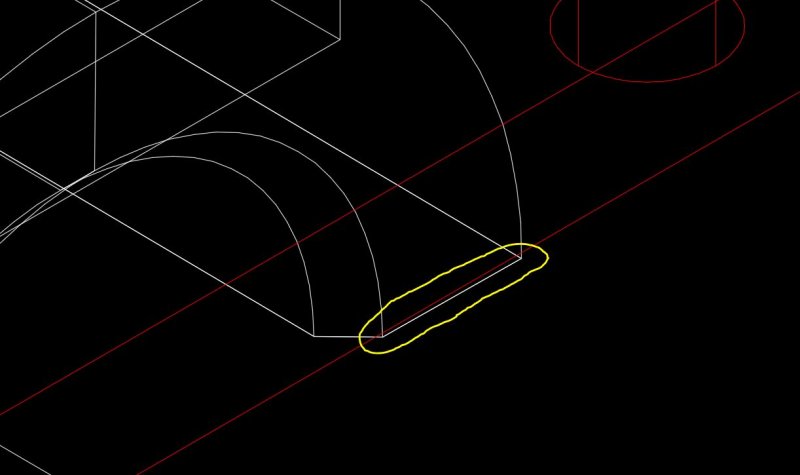

ReMark Posted November 17, 2014 Posted November 17, 2014 You might want to take another look at your drawing (both the 2D and 3D portions) before proceeding any further. The 2D top view of the object has Constraints enabled. Was this intentional? The 2D top view shows a chamfer at the front and back not a fillet (red dashed linework) yet your 3D arch appears to be filleted on the back and chamfered in the front. The 3D arch does not appear to be square with the base. If you look closely at the right hand side of the arch while in a 2D wireframe visual style you will see what I mean. This could cause you a problem later on. Quote
ReMark Posted November 17, 2014 Posted November 17, 2014 This is what I came up with based upon the drawing you provided. I had to make a couple of guesses as you did not provide a dimensioned front view of the object. I drew one end then mirrored it. I revolved a profile for the arch then added the somewhat rectangular piece that runs through the middle of the arch. I created that piece with an extruded profile. Finally, I joined all the pieces together using the Union command. Quote
sandualex Posted November 17, 2014 Author Posted November 17, 2014 Thank you both for the replies,I managed to remove the part I neede by creating a circle,extrude it ,and then subtract from the whole.Thanks a lot and I'll be sure to ask for help here when I need it. Quote
ReMark Posted November 18, 2014 Posted November 18, 2014 (edited) Did you retain the constraints that you had applied? Did you fix the geometry on the right hand side of the arch? Edited November 18, 2014 by ReMark Quote
sandualex Posted November 18, 2014 Author Posted November 18, 2014 Yes,I fixed the geometry(was a a mistake I made at earlier in the project),and I turned off the constraints.Thanks for pointing that out !!! Quote

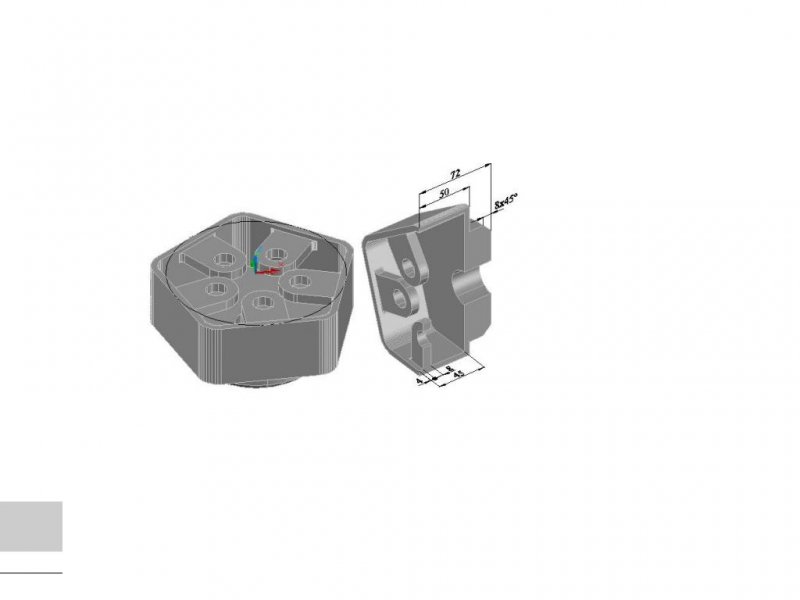

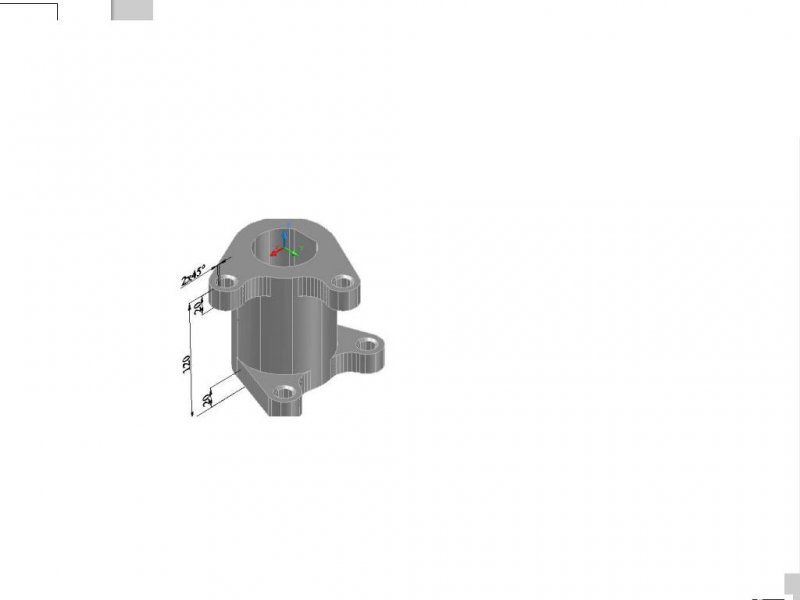

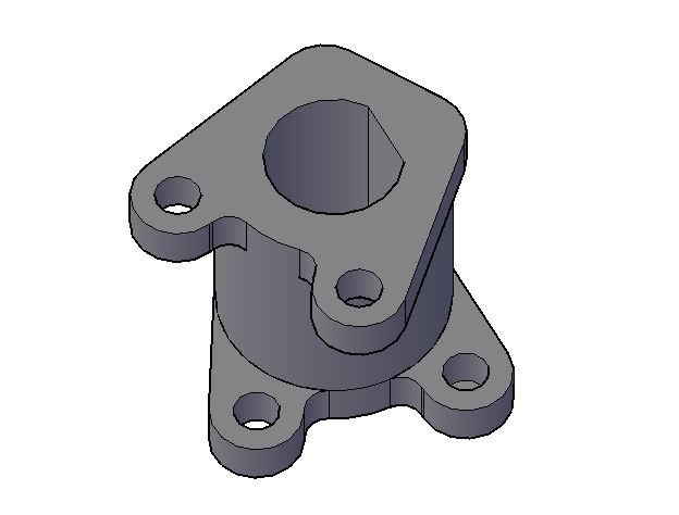

sandualex Posted November 18, 2014 Author Posted November 18, 2014 Since we're at it,I want to know,regarding that outer edge on top,would be a good ideea to create a copy and place it in the exact same spot,extrude one for the full lenght,then the next for the rmaining length,and then subtract one from the other so leave me with the desired thickness? Also,how would you go about on this one? Quote

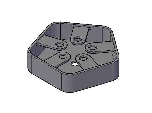

ReMark Posted November 18, 2014 Posted November 18, 2014 The object in the top image has three main parts two of which appear to be exactly the same (but one is rotated different than the other) separated by a cylinder. In essence you only need to create two parts. Follow me? To create the object in the bottom image I'd construct my five-sided base first. Then I would create a single tab (with hole) and use the Array command with the Polar option. Is that basically what you were thinking? Is this all being done for an AutoCAD class or are your teaching yourself? Quote
ReMark Posted November 18, 2014 Posted November 18, 2014 Submitted for demonstration purposes only. Object is loosely based on your submitted image. Model is not complete. Understand? Quote
sandualex Posted November 18, 2014 Author Posted November 18, 2014 Yes,this is what I have been thinking,and to answer your question,yes,is for the AutoCAD class.The first one was assigned to me,but the other two to other students,but I decided to work on it myself to improve my skills.So a little bit of both. Quote
ReMark Posted November 18, 2014 Posted November 18, 2014 I admire your initiative. Good for you! Re: top image in your previous post. After giving it some thought I would recommend you make the top and bottom without the hole. Union these to the cylinder then using a profile for the hole extrude it (then subtract) or use PressPull having it pass through all three parts. Understand? Quote
