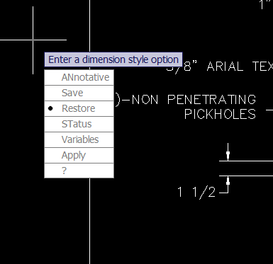

Bill Tillman Posted November 25, 2014 Author Posted November 25, 2014 Finally got to get back to this one. The attached screen shot shows what happens when we use this guy's profile and try to view the Dimension Style Manager. When logged in as a different user, this does not happen. Instead I get the Dimension Style Manager dialog that I expect. Now, here's the trouble. This guy is in another location and he has customization out the wazoo so doing a re-initialization is going to make for some very unhappy people. True, we can back up his profile and then try it but I'm afraid if we put back what he's customized we will just recreate this same issue. I asked him about the customization and he's clueless. Has absolutely no idea of what's been added to this machine over it's life, etc...so we have to proceed slowly. That said, can anyone tell me what environment setting would do this in AC 2009 vanilla and most important, can I set it back to the other setting which will show the standard Dimension Style Manager window without undoing all his custom settings? Quote
SLW210 Posted November 25, 2014 Posted November 25, 2014 That is what you get when you use -DIMSTYLE (Hyphen in front) to suppress the Dialog box, so what ever command is being used to call up the Dimension Style Manager is using the one to suppress the dialog box. Quote
Bill Tillman Posted November 25, 2014 Author Posted November 25, 2014 Okay, that makes sense. This menu appears when I select Format>Dimension Style from the menu at the top of his screen. So that means someone, or this guy, either customized his menu or perhaps there is a global setting that turns off dialog boxes. They are so busy over there the IT guy and I only get a shot at this about once a week, and then for only about 10 minutes before we have to turn it back over to him. He is unaware of any customization that was done, (famous last words for a CAD manager) but obviously something has been done. And resetting everything to default will most likely write over years of customizing so we're going to create a new user and let him work it that way. If all goes well then we can start trying to resolve this issue. But there are too many customization over there for us to blindly reset everything to default. Thanks. Quote

Dadgad Posted November 26, 2014 Posted November 26, 2014 (edited) Okay, that makes sense. This menu appears when I select Format>Dimension Style from the menu at the top of his screen. So that means someone, or this guy, either customized his menu or perhaps there is a global setting that turns off dialog boxes. They are so busy over there the IT guy and I only get a shot at this about once a week, and then for only about 10 minutes before we have to turn it back over to him. He is unaware of any customization that was done, (famous last words for a CAD manager) but obviously something has been done. And resetting everything to default will most likely write over years of customizing so we're going to create a new user and let him work it that way. If all goes well then we can start trying to resolve this issue. But there are too many customization over there for us to blindly reset everything to default. Thanks. Yeah Bill, it sounds like the MACRO has been changed for the button. When I use the FORMAT > DIMSTYLE approach, I get the dialog box. Sounds like somebody (perhaps mistakenly) changed the default/desired (dialog display shown) definition of "_dimstyle" to "-dimstyle", and that if you changed that back in the cui that you would be back on the tracks. Edited November 26, 2014 by Dadgad Quote
