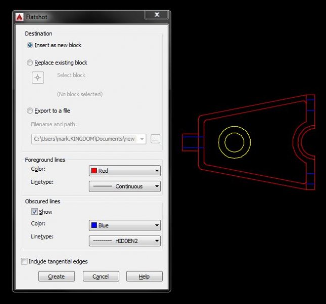

ReMark Posted November 19, 2014 Posted November 19, 2014 (edited) Flatshot gives the user the ability to assign but two colors, one for Foreground lines and one for Obscured (hidden) lines. Note that the block created by Flatshot in the above image however has three colors. How did that happen? I changed the Layer of the two circles to one assigned the color yellow using the BEDIT command then saved my changes. Couldn't you do the same for your crane? I don't think a new visual style is going to accomplish what you would like to do. Edited November 19, 2014 by ReMark Quote
