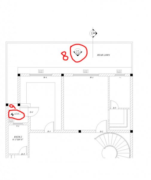

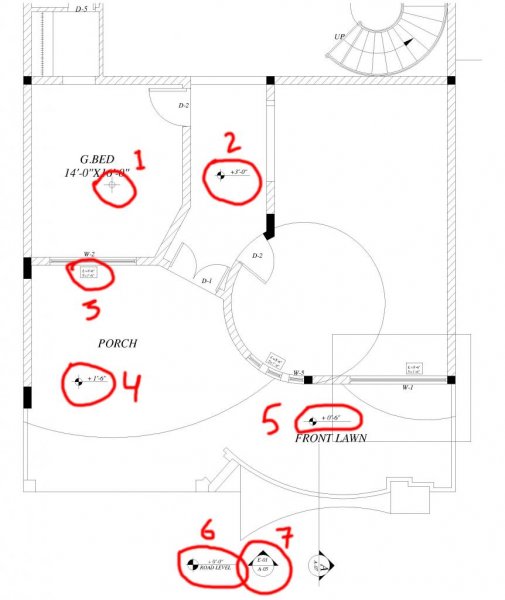

MIRZA_ATIF Posted November 26, 2014 Author Posted November 26, 2014 hi, I am attaching some pics here please tell me the detail of these symbols with number thanks... WBR Quote
ReMark Posted November 26, 2014 Posted November 26, 2014 You realize you initially asked about symbols used in a civil engineering drawing yet you post images taken from an architectural drawing? Numbers 7 and 8 will the user to an elevation view that will appear on another sheet in the drawing set. Number 9 (and others similar to it) appear to be referring to actual floor/surface elevations. I have no idea about numbers 1 and 3 at the moment. Too faint for me to clearly discern. Quote
eldon Posted November 26, 2014 Posted November 26, 2014 1 might be the position of a light, and 3 might be the details of a window, but it is a bit indiscernible. Quote
ReMark Posted November 26, 2014 Posted November 26, 2014 I too was thinking number 1 could be a light but it is the only one shown on a drawing that has at least six rooms. Strange that someone from Pakistan would reference a drawing done in imperial units (architectural feet and inches). I would have expect metric units. The OP did not inquire about the section symbols either. Quote
MIRZA_ATIF Posted December 1, 2014 Author Posted December 1, 2014 Thanks to """REMARK""" i was just need of legend i found it on internet and it was much helpful for me. Thanks again Quote
Handiman Posted December 2, 2014 Posted December 2, 2014 #1 is a ceiling J-Box (4 square box) for a ceiling fan. It is usually mounted to the structure to support the fans weight. It can be just a light. Quote
