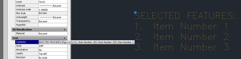

I'm adding some text in the notes section of a drawing using LISP and would like to use numbered list. In searching for how to format the string to add numbers I'm only finding limited information. I need the list to look like this when it's on the page
  1. Note #1
  2. Note #2
  3. Note #3 and this paragraph shows how the text will be formatted correctly and wrap the desired way with an indent on the left side to align with the other text using a numbered list.
  4. Note #4
So far I've found that \pxi does something like this but I haven't found the correct way to turn it on and off when needed.

Thanks. I have found how AutoCAD formats a numbered MTEXT list by creating one and then looking at it's properties. See attached screenshot. If I follow this correctly, I will need to first know the number of items in the list. This is for my infamous automated process so there are no users around to click a mouse or enter text. And the number of items in the list will always vary depending on the type of drawing being created. So I think I can make a first pass through the optional features and for each one to be included increment a counter so I can then format the string....but I still think there has to be an easier way.

Just setup an MText the way you want, and then dig through the MText Object's TextString Property.
Example:
\pxi-3,l3,t3;1.[color="red"]Note #1[/color]\P2.[color="red"]Note #2[/color]\P3.[color="red"]Note #3 and this paragraph shows how the text will be formatted correctly and wrap the desired way with an indent on the left side to align with the other text using a numbered list.[/color]\P4.[color="red"]Note #4[/color]
Or maybe not....WOW Black Box that looks like you have something there. Now, is the pxi-3, l3 is a little confusing in the example I use because it has three items in it. I just added some more items to the list and noticed that pxi-3 remained the same. So, it looks like all I have to do is reinstall the counter I was using earlier....darn I really was hoping MTEXT would handle the auto increment for me. Won't be easy but I think I see to do this now. Thanks.
Give this a try... Working here:

This is working and it's actually building the numbered list I'm looking for. I just gotta work on the location (x,y,z) to place it and get some more work done on properly building the string to pass to it. And I guess I'll still have to use a counter to build the string correctly. I'm going to keep at this after lunch.

Yes, many thanks for the input. I have it working nicely now. The \t (tab) character was important in the string. And this handles whatever I throw at it. I just typed in what I wanted and then did a quick (entget) on the object to see how the text was being formatted. If I build the sting like that, even using a counter as well as a split with non-numbered lines and then it picks up a new numbered list in the second section. Works great but I'll probably tweak it some more once the users start asking questions about it.
