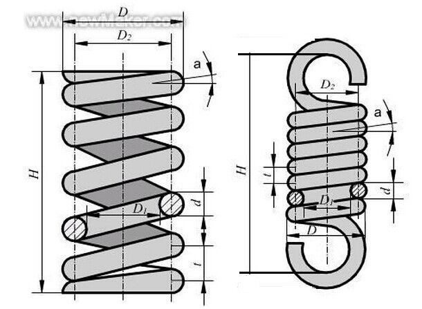

I want use a routine to drawing the springs, need help.
The kinds of the spring
Parameter
The lengh(H), Outer diameter (D), Pitch(t), diameter(d), Spiral Angle (α=5°~9°), Number of turns(n), need enter by user .
if enter the lengh(H) ,so not enter the Pitch(t)
if enter the Pitch(t) ,so not enter the Lengh(H)
Enter parameter , pick a basic point ,
The key is drawing the end of springs ,maybe is difficult .

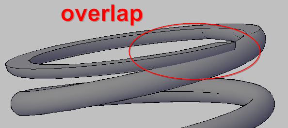

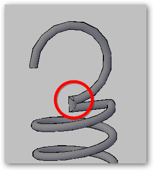

My attempt...
(defun c:springs ( / el p rmax rmin n ch1 ch2 hmax hmin h pitch helix do ci pl sols ss )
 (command "_.UCS" "_W")
 (command "_.VIEW" "_SWISO")

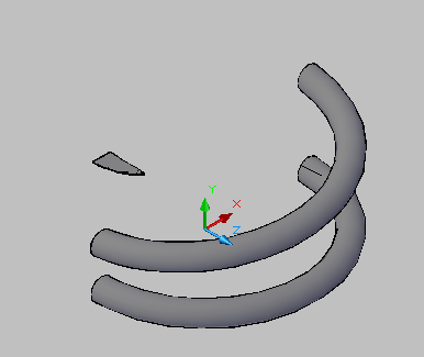

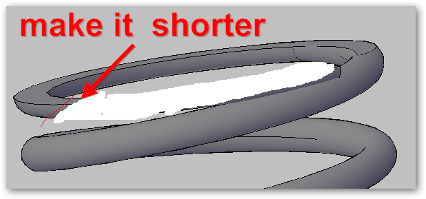

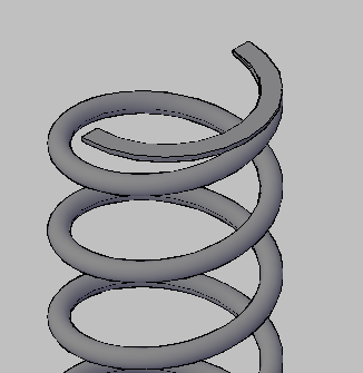

HTH, M.R.
BTW. Is maybe your brother famous snooker player Ding?...
Edited by marko_ribar
code modified again...

I tested, Find a little defective.
Compression Springs, have overlap at ends.
I think can make it shorter
if not work at wcs, will be like this:
Extension Springs ,The ends of the transition is not smooth.

Drawing Compression Springs have a little problem.

Oh, I see, I've modified it again... Thanks for checking...
