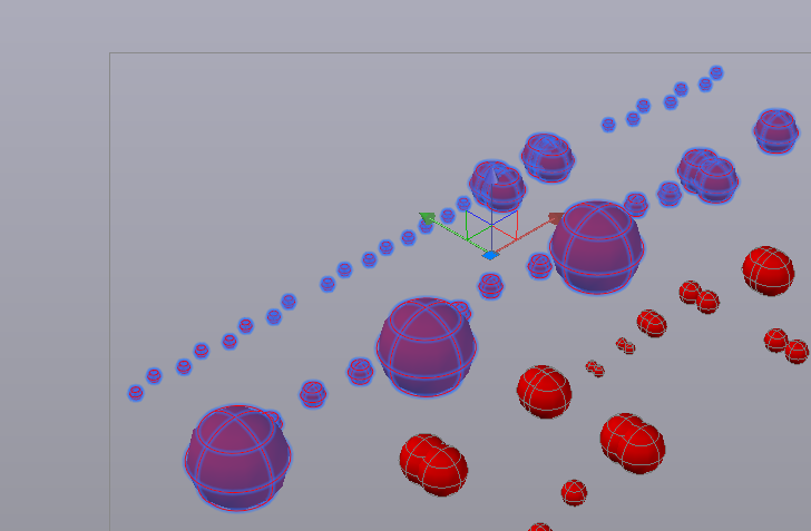

neospace Posted November 23, 2014 Posted November 23, 2014 How can I make a group of 3D objects bend or shape as a group? I have selected them and they act as a group to move them as a team, but want to shape them into a wave or 45 degree angle in space? attached is a screen shot of lighted group I want to shape. Thanks Quote

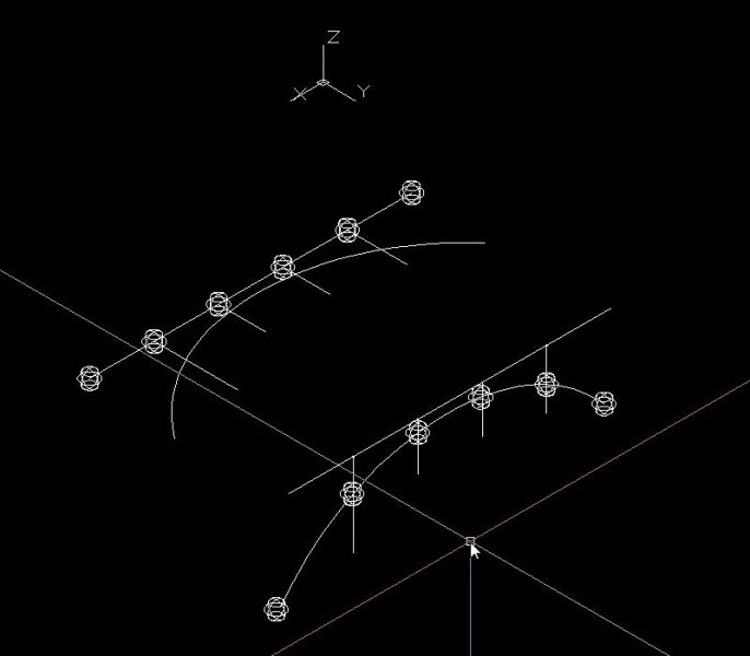

BIGAL Posted November 25, 2014 Posted November 25, 2014 If this image makes sense the spheres now have a different Z based on an arc. Quote
neospace Posted November 26, 2014 Author Posted November 26, 2014 thank you BIGAL... this is what I want to do... make changes along the Z axis.... want to make 45 and 90 degree turns as well, maybe even spirals... can you tell me a process to this? thank you. Quote

neospace Posted November 27, 2014 Author Posted November 27, 2014 it would be 3 to 50 or so that would change direction, depending on the design aestestics. Because the "popcorn" is coming off a template that is complicated by itself, I would like to change a section of it to turn 45 or 90 or arc on Z axis vs draw the z and place "popcorn" ... In other words want to impose the 45, 90 or arc on the already set up string vs. re-aligning each one again.... because the x and y was placed by hand already. Quote
