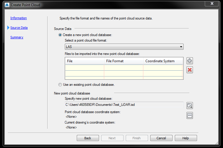

I then try going to Civil 3D directly, loading the files in as a Point Cloud. Info typed in, I move to Source Data and pick a few LiDAR Files. Civil 3D DOES recognise these files as LiDAR, but it DOES NOT add them in as "Files to be imported into the new Point Cloud Database."

Issue resolved itself. Turns out it's borehole data that goes 2km deep, and used Gamma radiation (Yeek!) to generate info. on the ground conditions. It then saved as a LAS file, which is why it wasn't working and had our heads scratching.
