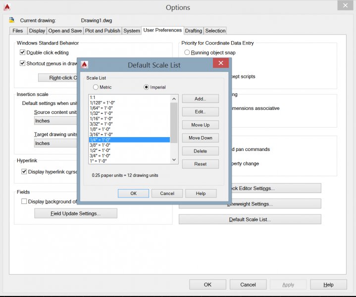

snakeyes Posted November 25, 2014 Posted November 25, 2014 So it has been a very long time since I used CAD but its all coming back to me except this. i have come to a firm where they have been drawing everything in model space using DECIMAL units, inches. then on paper space everything is scaled to 1:20 and it all works out to 1" = 20', I've printed and measured and it works. I am used to changing units to Architectural, inches, and drawing 1:1. My issue is when I try to scale it so as 1"=20' nothing works, the drawing becomes so huge it cant be seen. I have gone as far as drawing a line 1 inch and when i set the paper space to 1"=1" it still does not measure correctly. Please someone tell me what I am doing wrong, I'm so lost and getting frustrated. Quote
ReMark Posted November 25, 2014 Posted November 25, 2014 1:20 metric is roughly equivalent to the imperial scale of 3/4"=1'-0". It is not the same as 1"=20'. Your paper space viewport needs to have its scale set to 1"=20'. If that scale hasn't already been added to the scale list you need to do that first. There should be no need to set the paper space scale. The default for imperial drawings is 1 inch = 1 unit which is a 1:1 scale. A scale of 1"=20' would be equivalent to 1 paper unit = 240 drawing units. This is how you set it up in your scalelist. Quote

ReMark Posted November 26, 2014 Posted November 26, 2014 (edited) Maybe I need a refresher course. In all my years doing civil engineering work I've never seen a drawing that purported to be drawn at a scale of one inch equals twenty feet designated 1:20. I've seen hundreds of drawings with the scale designation of 1"=20' or 1"=20'-0". snakeyes: Try this. Make the viewport active. Invoke the Zoom command. Now select the Scale option. When you are prompted to enter a scale factor type in the following: 1/240xp then press the Enter key. What happens? Can you now see your entire line in the viewport? Yes or no? For a list of common imperial architectural and engineering scale factors click on this link. http://www.archtoolbox.com/representation/cad/scalefactor.html BTW...Using the Zoom > Scale method was the very first method used to set a viewport scale when the concept of paper space and viewports were added to AutoCAD. It wasn't until later that scale lists were added. Remember, you want 1 inch in paper space to equal 20 feet. One foot is 12 inches; twenty feet is 240 inches. 240? Doesn't that sound vaguely like a n/xp scale factor? Edited November 26, 2014 by ReMark Quote

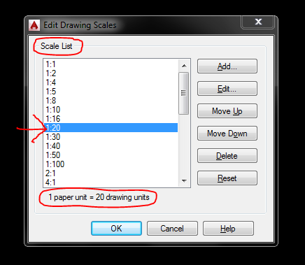

Dana W Posted November 26, 2014 Posted November 26, 2014 The viewport scale factor for 1:20 is not the same as the scale factor for 1"=20'.Who is talking about scale factors? Besides, it depends on your units, which is my entire point. What's pertinent to my point is what is in the scale list item definition and what are modelspace units. Oh, yeah. This is what I get. This is acadlt.dwt. Why doesn't your window show the little decider buttons up top there? Maybe this is another way LT is made LT, by not flupping up the screen with all them extra ratio thingies. By the way, a ratio such as 1:20 is neither metric nor imperial. Quote
