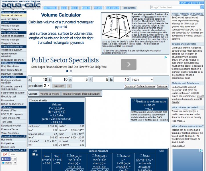

The formula gazza_au posted applies to any manner of truncated pyramid. The more regular truncation of the pyramid in rectangle-loft.dwg could have it’s volume derived by two applications of the standard (Base to Point) pyramid equation:
V = 1/3 * w * l * h
One for the full pyramid 1/3 * 10 * 10 * 20 = 666.6667
One for truncated portion 1/3 * 5 * 5 * 10 = 83.3333
Actual volume of truncated pyramid = full pyramid – truncated portion.
