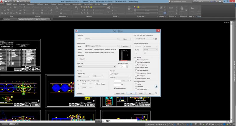

For some reason when I try to plot the Arch D size to my plotter after I just got a new computer, it will use up the full 36" long sheet size, but it will only print 11x17 size on the paper. I have tried to uninstall and reinstall the drivers. I have updated the drivers and then installed a new one. I am just not sure what else to try. I have Windows 8 on this new computer and CAD 15 and HP DesignJet 790 24". Anyone have any suggestions to try or had this problem also and know how to fix it?
Can you post a screen shot of your plot settings?
Does Plot Preview show correctly?
Screen Shot.jpgYes the plot preview shows it correctly, and all my settings are the same that I have been using for years. So I am not sure what is going on, or if it just a driver issue.
Check the "Properties..." of the plotter, usually if Plot preview is correct, the trouble lies with the Plotter properties and/or the driver.
That worked! Thanks! Now I feel stupid for not trying that. lol. Much Appreciated!
