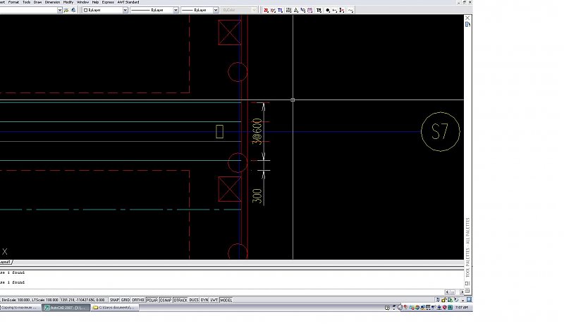

another lisp i would like is similar to this but not the same, is we normally xref in a floor plan, and draw reinforcement over the top of that. so in a new drawing we will xref in our floor plan. I would like a lisp where we select two vertical lines on the xref, (which in this example are 2400mm apart, and autocad puts in 4 vertical lines the same length, but spaced as - first line 300mm to the right of the left most line, then another line 600mm to the right, then another line 600mm to the right, and the same again. So we will have - xref vert line, 300mm spacing and a new line, 600mm spacing and a new line, 600mm spacing and a new line, another 600mm spacing and a new line, leaving 300mm to the next xref line. ultimately if autocad could ask us for the two vertical xref lines, ask us for the first offset (300) and then how many lines we want, then the last offset ( 300) and it would spread them out evenly. IE start lisp, click on first vert line, input spacing of 300, input i want 4 lines in total, input last ofset as 300) autocad would then work out if i have 300 = 300 offsets, it leaves 1800 mm, and with 3 spacings it knows they have to be 600mm. This probably sounds complicated, i will post up a pic if someone needs it explained better
thanks for any help
This is not to difficult IF the xref is not scaled and the lines are vertical.
A picture or DWG with the before lines & then after lines.
Thanks alot for that code, works a treat :) the second one i want looking like the attached image. The two red lines (horizontal, but are sometimes vertical are the xref. I want a macro to add the cyan lines. The two red lines are 2400 apart, and the first cyan lines inboard are both 300 off the red line, with equally spaced lines between. Id like to be able to select the two red lines, and it automatically put in the 2 outer most lines 300mm off, and then ask for how many more lines we want, and equally space them. Thanks alot for your help
Sorry the photo doesn't have enough contrast or detail for me to see the lines clearly.
