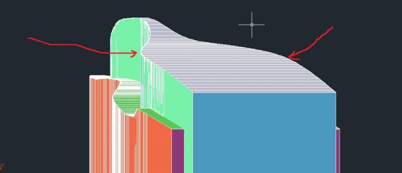

bavdeyka Posted December 9, 2014 Posted December 9, 2014 (edited) Could you prompt me on how to create an intersection with radius of 3 mm along the edge marked with red arrows? I keep stumbling upon an error:( Edited December 9, 2014 by bavdeyka Quote

ReMark Posted December 9, 2014 Posted December 9, 2014 (edited) Create an intersection? Do you be a fillet? How did you create this in the first place? Edited December 9, 2014 by ReMark Quote
bavdeyka Posted December 9, 2014 Author Posted December 9, 2014 ReMark, you're right..as usual) another localization issue:x Quote
ReMark Posted December 9, 2014 Posted December 9, 2014 Well I've got bad news for you. I think the geometry is a bit off and trying to apply a fillet may not work. How did you create this object in the first place? Did you do it with surfaces? Quote

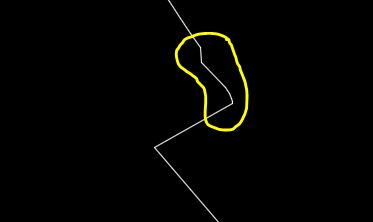

ReMark Posted December 9, 2014 Posted December 9, 2014 (edited) After exploding and erasing I took a closer look at the edge you want to fillet. Something seems amiss (you have a jog in your linework) and unfortunately it appears this way on both edges. Was that intentional? I think you had a similar problem in another thread of yours. Is this the same drawing we're talking about here? I tried the FILLET command, using two different options, but it failed. Edited December 9, 2014 by ReMark Quote
bavdeyka Posted December 9, 2014 Author Posted December 9, 2014 The drawing in the previous thread is the same edge. When the fillet command failed for the first time I extracted the edge and wanted to sweep the contour and create a smooth transition using boolean extraction. But I failed, though I hurried to write you about the successful result in my previous thread. My objective is to create a smooth transition along this line for more convienient connection of the details. I don't have any exact requirements for accuracy. So I'd do with just the visual effect of fillet, but I can't achieve even this... The jog is intentional as I contoured the object in .stl - if I haven't done it then, I'd probably already have driven you nuts with my questions:) Maybe you have some ideas on how to do it? I'm not a professional in 3D modelling, I just need to create some details for my hobby. Quote
