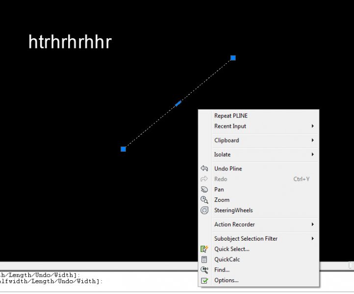

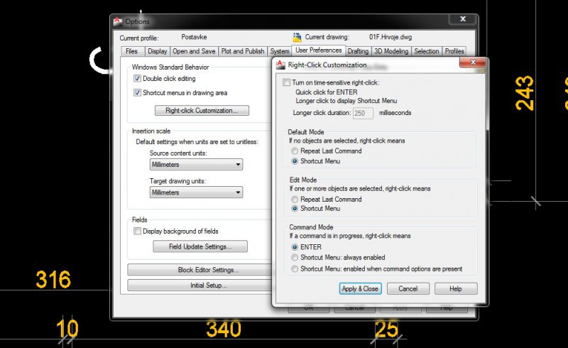

2.) My right click customazation isnt working as it was all this time...Till today, when I selected an object and hit right click I would get properties window...from there I could move, rotate, copy... the object....now I get some strange window...picture
