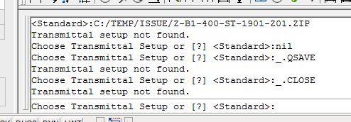

I restarted CAD and that sorted that, I ran Autoscript and loaded the scr you gave me and added a few drawingsAutoscript.JPG
I ran the script it then prompted me to select standard etransmit setup, I then selected create transmittal package, it then prompts me for a file save location so I save and it only creates one etransmit of the first drawing on the list. Am I missing out on something I should be doing

I got it working I wasnt calling transmittal setup Bound so rename it and that worked great, thanks for that. I would love to be able to make something like that myself have you had specific training or have just went about learning lisp yourself
