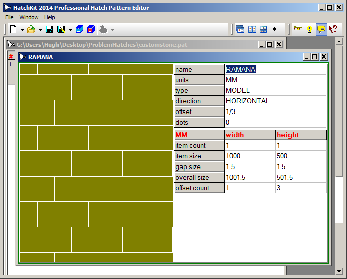

I am working on a project where client need the detail of the stone clading work with 1.5mm space the size of the 500x1000 with the space of 1.5mm. I have tried i am getting the the pattern but unable to get the space
SOME PROBLEM WITH MY CODE, PLEASE SUGGEST ME...

Parameter count per line normally should be 7, you have 7/8/6/7 ...
Please describe how your 500x1000 tiles are arranged - apart from the 1.5mm gap. Are they stacked or offset? As an example the pattern derived from the screenshot is :

*RAMANA,HORIZONTAL 1000mmx500mm bond=1/3
;%TYPE=MODEL
90,0,0,501.5,-333.833333333,500,-1004.5
0,0,500,-333.833333333,-501.5,1000,-1.5
-90,1000,500,501.5,-333.833333333,500,-1004.5
180,1000,0,333.833333333,501.5,1000,-1.5
It's very easy to generate another ...
