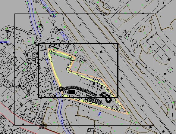

I got the original drawing with scale 1:1000, and I need to print it at 1:300.
and I have decided the area for printing.
em..I am confused with the paper size and plot scale.
If I choose A2 paper, should I plot the scale to 1:3.3? (in mm)
and does 'fit to paper' option matter?

I get this drawing from the city government.. I want to re-design the selected area (for assignment)

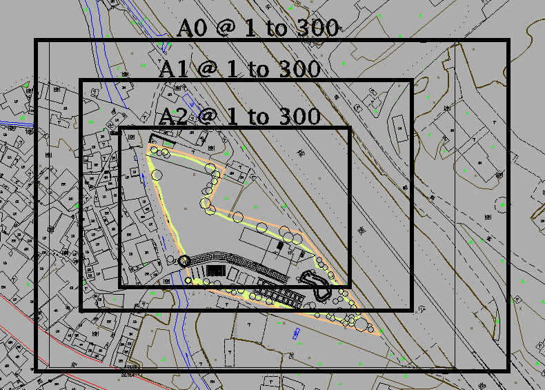

I wonder why you need to plot it at 1 to 300 :?
I plot from model space, and the image shows an A2 sheet at 1 to 300.
Perhaps an A1 sheet at 1 to 500 would encompass the area better :unsure:

To fit the rectangle you have marked on the drawing, you would need to go to a paper size of A0, using a layout scale of 3.33333333:1, I did find a couple of cars in the drawing and they are 6.5 meters long ? Is there anything in the drawing other than the grid markers, that you know the size of just to verify that the drawing is correct.

@eldon: thank you! I can now clearly see that A2 paper doesn't fit...1:300 scale is required.../.\ did you use layout and viewport ?
@steven-g: oh no! A0 size paper is too big...and thanks for spotting out the mega-size cars!!!

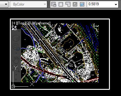

1st thing draw a new title block in the layout view at true size for A2 594x420 then add a mview window inside it, your sheet size is very odd. Once in the new mview you can set a scale. this is your project a A2 at zoom extents you can see the little number in the layouts tool bar I changed that to 0.5 which is a true 1:2000 scale.
