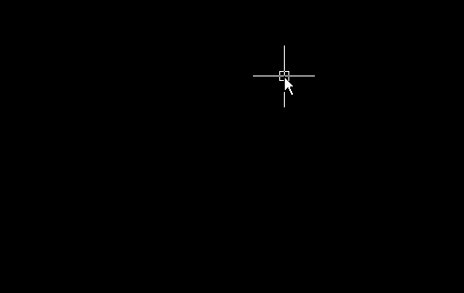

Why I can't change the Hatch scale ?
I don't know why this routine can't change the hatch scale , Someone can help ?

I use "properties" can see scale is changed. But Hatch no change ! why??? Use "regenall" , is same!
If the type of the Hatch object is User_definied , so you can not change the scale .
To check that out , just select the hatch object and right click on the object and choose Properties and from that pattern check the type property of the object .

Mr.Tharwat , My code can change hatchspace & hatchscale , I can see it from property. But hatch can't update. why ?
Can you upload a sample drawing ?
