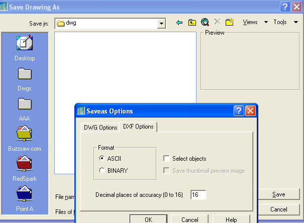

eldon Posted January 7, 2015 Posted January 7, 2015 Have you tried the option to Select Objects when you DXFOUT ? Quote
eldon Posted January 7, 2015 Posted January 7, 2015 I have an older version of AutoCAD, and when I start the DXFOUT command, I get a "Save Drawing As" dialogue screen, and at the right hand end of the top line, there is a Tools button. Pressing this reveals the Saveas Options, and when you click on the DXF Options, you can then check the Select objects. You should be able to follow this on your version, but the screens might be a bit different Quote
