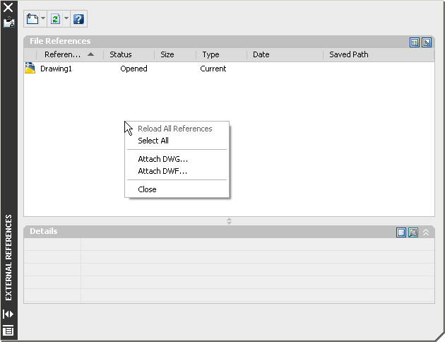

SeaRR85 Posted December 15, 2008 Posted December 15, 2008 I'm trying to insert an image into my drawing and I've done it before using the external references, then selecting "Attach Image" from the drop down menu. For some reason this option doesn't appear anymore (See attached Screen Shot). Is there a variable that I need to set to get this option back? Please let me know! Thanks! Quote

SeaRR85 Posted December 15, 2008 Author Posted December 15, 2008 I'm 100% sure that LT has the option because I've done it before using LT. Weird that it just got up and left. Thanks for the reply. Quote

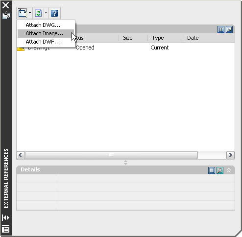

SeaRR85 Posted December 15, 2008 Author Posted December 15, 2008 Thanks for all the replies. 'imageattach' doesn't work in the LT versions. The drop down menu doesn't have 'Attach Image' either. Check it out. Here are some External References I've used before this problem with the same exact AutoCAD LT 2007 I'm using right now. There was a time where I could have xrefs and here is the picture to prove it. I don't get it! I want it back... Quote

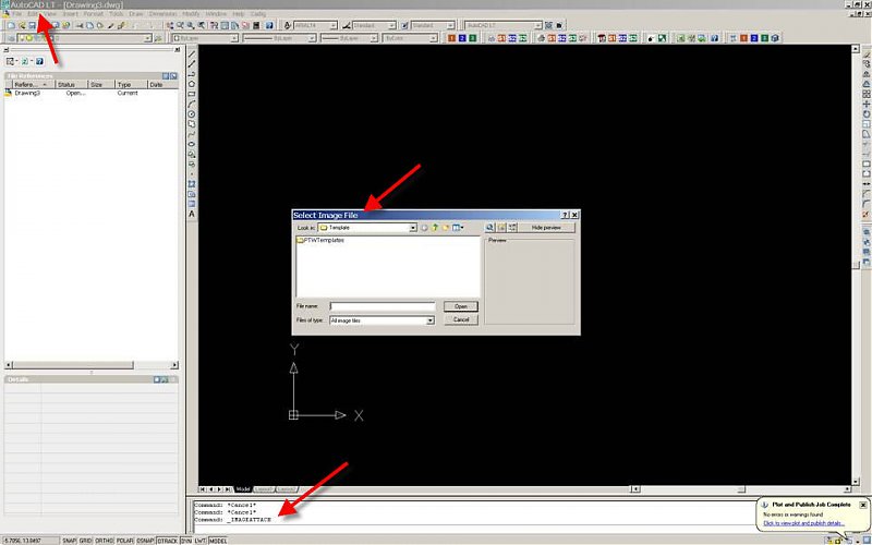

SeaRR85 Posted December 17, 2008 Author Posted December 17, 2008 I'm not flippin' out. Here is a screen shot of my friends AutoCAD LT 2007 with image xref capabilities. Notice the 'imageattach' command and the 'select image file' window. Quote
