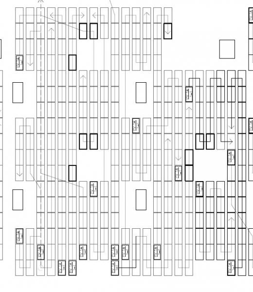

Has anyone seen or created a string that would take a PV module layout and "string them" based on a predefined # of modules. See attached photo sample
Search first forTravelling Salesman Problem (TSP) maybe very simplified in your case (n x 90°).
