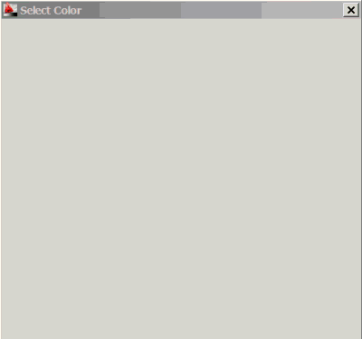

nestly Posted January 15, 2015 Posted January 15, 2015 Are you certain you're not using "Index colors"? TrueColors have values such as 106,102,90. Index Colors are 0 thru 255. Yikes, my animated gif software doesn't like 16M colors... lol Quote
