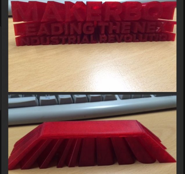

kalschne Posted January 14, 2015 Posted January 14, 2015 (edited) I want to know how can i extrude/cut a text with an angle until another face, extruding like a pyramid. Something like this: http://pballew.net/frustum.bmp With the text starting in the bigger face and finishing at the smaller one. Is it possible? Edit: I'm using AutoCAD and i have to do with these letters: ㈜영일교육시스템 (is korean). Here is an example exactly i want to do: http://imgur.com/a/PpfMO Edited January 15, 2015 by kalschne Quote

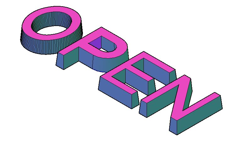

ReMark Posted January 14, 2015 Posted January 14, 2015 Done in AutoCAD using the method IRM suggested (Extrude with Taper option). Taper angle was +5. The letter "P" had to be worked on a bit to get it to cooperate. Results may vary with the font being used. Quote

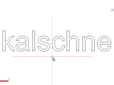

ReMark Posted January 15, 2015 Posted January 15, 2015 What font are you using? Did you explode the text first by using the Express Tools Explode Text command? After that follow the advice IRM gave you. If you still can't figure it out then attach a copy of the .dwg file to your next post and someone here will take a look at it. Quote

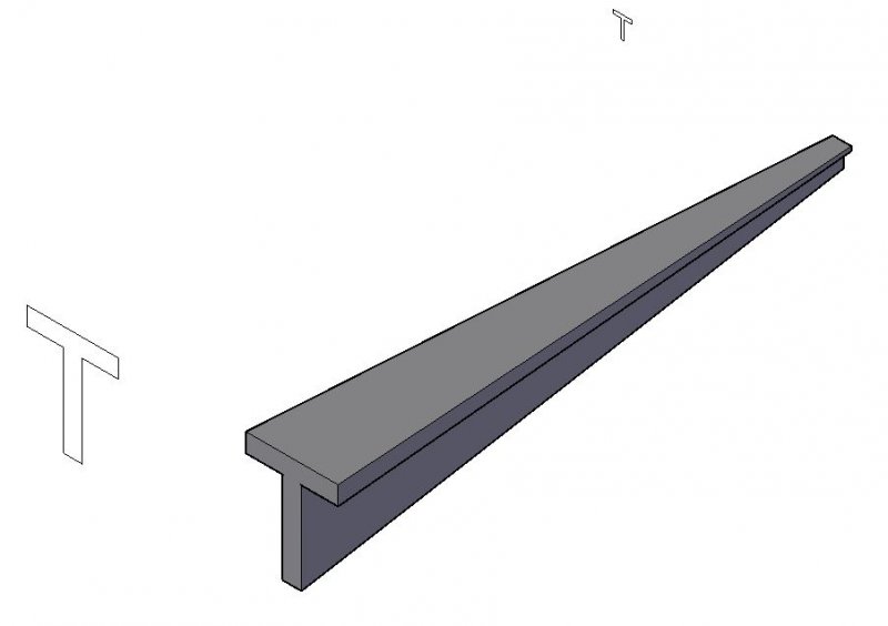

ReMark Posted January 15, 2015 Posted January 15, 2015 Tapered letter "T" created using two profiles and the Loft command. Letters are centered on each other using the midpoint of the top of the letter. Maybe this will give you some ideas. Quote

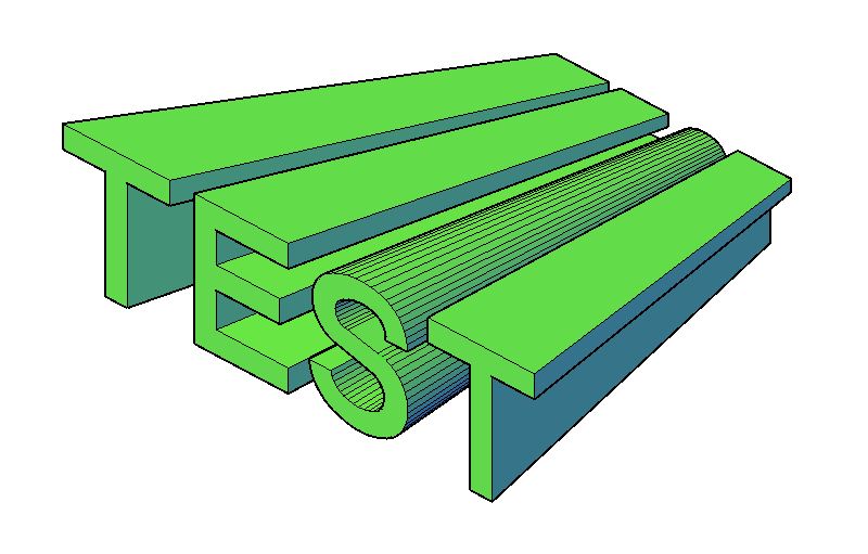

nestly Posted January 15, 2015 Posted January 15, 2015 (edited) Try turning the letters into REGIONS, COPY the Regions to the desired elevation, SCALE the elevated Regions to the desired size, Loft the lower region to the matching upper region one at a time. The "a" and "s" did twist unexpectedly during LOFT in the animation below, but I imagine that could be worked out. *edit* LOFT from larger letter to smaller letter seems to have resolved the "twisting" problem Edited January 15, 2015 by nestly Quote
ReMark Posted January 15, 2015 Posted January 15, 2015 Tapered letters. Text height front = 1; text height rear = .5 Dropped the letters in the rear half the height. Quote
