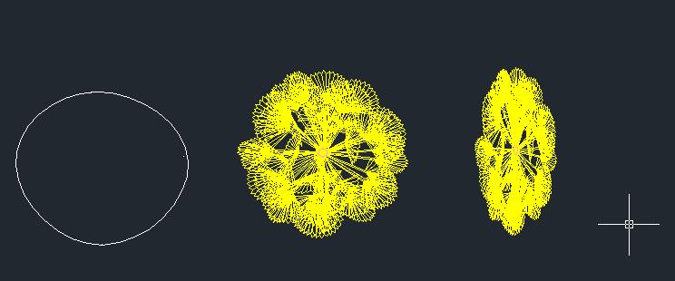

Lee I have just opened your dwg and this is what I managed to create yesterday. Thanks! I'm still not fully educated with blocks at the moment as I am half way through a Level 3 C&G course in 2D CAD.
