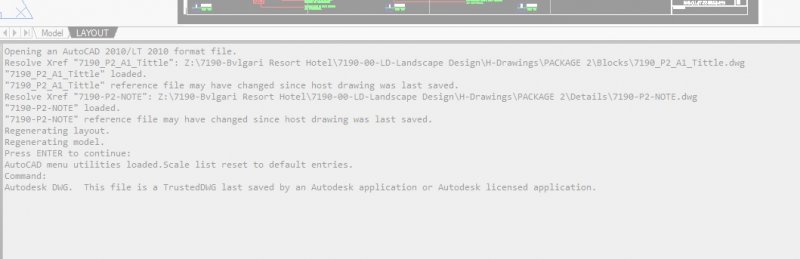

ybx Posted January 21, 2015 Posted January 21, 2015 Dear members.... I am facing a problem in autocad when i open a file it is stuck with a messeg (Autodesk DWG. This file is a TrustedDWG last saved by an Autodesk application or Autodesk licensed application.) and it will open after 50/60 seconds... AM ATTACHING HERE THE IMAGE Can anybody help me to solve this problem Thanks..... Quote

ybx Posted January 22, 2015 Author Posted January 22, 2015 Hi.. i could see one lisp is generating automatically in folder when i open any file from folder in that folder an automatically a lisp file is creating lisp name (acaddoc.lsp) i think this is the problem for hang how to avoid this Quote
ReMark Posted January 22, 2015 Posted January 22, 2015 The fact that this lisp is generating multiple copies of acaddoc.lsp in multiple folders means you have a virus. I think it is the acad.vlx virus. See post #8 of this thread....http://www.cadtutor.net/forum/showthread.php?58117-acad-viruse&highlight=acad.vlx Quote
ReMark Posted January 22, 2015 Posted January 22, 2015 Read this....http://knowledge.autodesk.com/support/autocad/troubleshooting/caas/sfdcarticles/sfdcarticles/How-to-detect-and-remove-the-Acad-vlx-virus-s.html?v=2013 Quote
