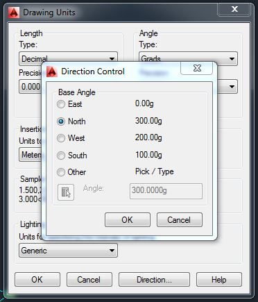

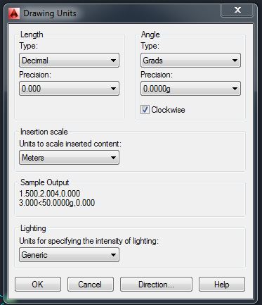

Hi i am using the following settigs (look the photos).
Can any one update the code to grads and meters ,and support lines and polylines
