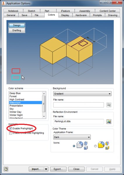

Regarding not being able to see a line to click on with the plane tool, is your "Enable Prehighlight" box checked on the colors tab under Application Options? See below:
It's under the Tools tab on the main ribbon, then click Application Options. The above is the dialog box that pops up. Go to the colors tab and verify highlight is checked
[ATTACH=CONFIG]52497[/ATTACH]
Hi, yes "Enable prehighlight" was checked. Thanks for your assistance :)
