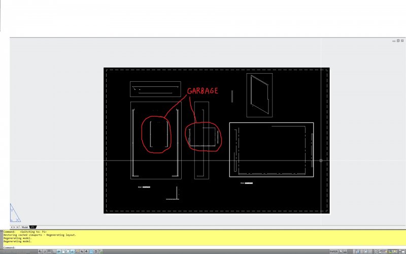

Kuli24 Posted January 26, 2015 Posted January 26, 2015 Hey. I open a dwg file, scroll around in paper space, go to model space, scroll around, go back to paper space, and all of the lines are messed up. It's almost as if model space has merged with paper space and I'm looking through it. I can see exactly what I see in model space IN paper space along with the other stuff. Regen doesn't fix it. This glitch happens on every computer EXCEPT the computer the file was created on. Help is appreciated. Thanks. Quote

SLW210 Posted January 28, 2015 Posted January 28, 2015 What about showing some screen shots of what you are seeing? What version of AutoCAD were the drawings created with originally? Quote
Kuli24 Posted January 28, 2015 Author Posted January 28, 2015 What about showing some screen shots of what you are seeing? What version of AutoCAD were the drawings created with originally? I've attached a screenshot. I believe they were created with AutoCAD 2012 because that's what we're all running, but it may have originally been created with an earlier version and then modified with 2012. Quote
ReMark Posted January 28, 2015 Posted January 28, 2015 (edited) Look like duplicates of your model space geometry overlaid on your viewports. Maybe you have one large viewport sitting atop the smaller ones? After using QSelect to find all viewports AutoCAD says 8 found. Guess that rules this idea out. Or could it be graphics card related? Edited January 28, 2015 by ReMark Quote
SLW210 Posted January 28, 2015 Posted January 28, 2015 There is a known glitch with 2010, 2011 & 2012 AutoCAD mostly related to Titleblocks,/blocks, created in earlier versions of AutoCAD. http://forums.autodesk.com/t5/autocad-2010-2011-2012/model-amp-paperspace-quot-ghosting-quot/m-p/3595728 Could be graphics card related, also. Quote
