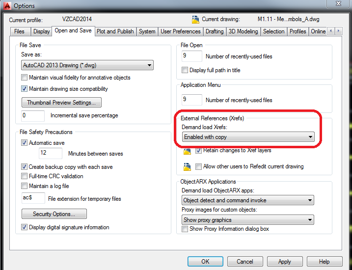

Its a “ Read Only Issue”… Whenever one work system opens a drawing all its Xrefs becomes Read only ( only for that single work system its happening)… When I personally open the drawing in my system I get a message read only but if I go and check, the other person did not open that particular Xref. I checked Demandload variable and its 3… Also checked the temp file folder which is right…
Some solutions please :cry::cry:
This should do the trick. This setting is different from "DEMANDLOAD".
