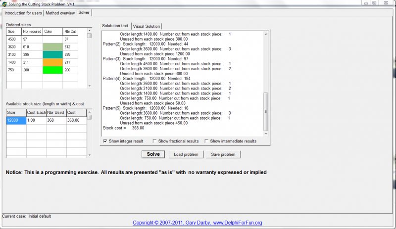

sergiu_ciuhnenco Posted January 29, 2015 Posted January 29, 2015 I have a global question for excell Gurus , somebody have any IDEEA how is possible to optimize the lenght of rebar for a least waste ? In my country the standard lenght is 12 meters For Example I have : 3 position Ø 16 lenght 4 m , 3 position Ø 16 lenght 5 m , 3 position Ø 16 lenght 3 m the best way it will be to cut from 12 meters 5+4+3 But somebody at building site can cut onother way , which will be uneconomic. I attach a workbook. is impossible every time create from bombinations 12 meters lenght but is important to get less waste. I posted this question also on excel forum , may here is other Ideas I don't to ofend other guys but I think here are the better mind Experiment.xlsx Experiment.dwg Quote

ymg3 Posted January 29, 2015 Posted January 29, 2015 (edited) sergiu, Your are after the 1d Cutting stock problem. Here is a link to a page where you can DL an executable that will do it. http://delphiforfun.org/programs/Cutting%20Stock.htm ymg Edited January 29, 2015 by ymg3 Quote

ymg3 Posted February 19, 2015 Posted February 19, 2015 tazzzz, Afraid not, what it does is to minimize the amount of waste when cutting the bars. It does also attempt to minimize the number of patterns utilized to reach a minimum of waste. ymg Quote
ymg3 Posted February 19, 2015 Posted February 19, 2015 sergiu, I've updated the lisp so that it might be easier to understand the results. ymg 1DCSP.LSP Quote

ymg3 Posted February 20, 2015 Posted February 20, 2015 sergiu, Here I've modified the lisp so it will read your file if you save it as csv. Don't want to mess with direct from excel as there are too many versions. The Output is still crude and to the text screen. To Run issue the command "SERGIU" ymg 1DCSP.LSP Experiment.csv Quote
